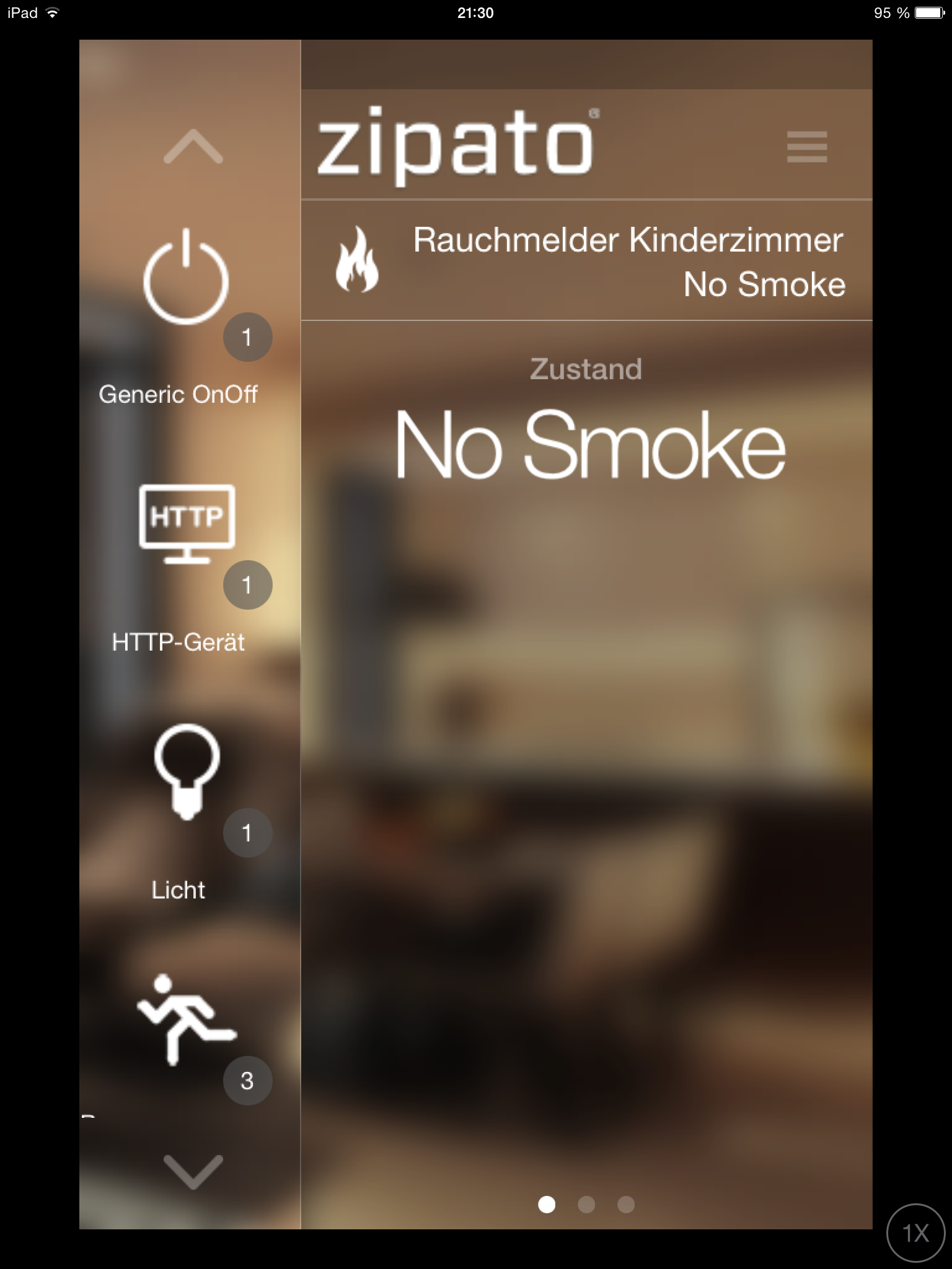

IOS app does not show STATE ???
Today I added a new device - FIBARO FGSD-002 SMOKE DETECTOR ( but i have the same problem with virtual weather station)
Dasboard shows the state:
IOS app does not show state:
Where is the problem ????
My IOS App shows the state crrectly. Its the same device. I think, there is a mistake in your settings.

I got the answer from Zipato support:
Please try to test the smoke sensor by pressing the test button and check again later state of the iPhone application.

I do not know why I can not edit the previous message .... anyway.
Zipato team was right, I had to press and hold the B button about 6s to activate the Smoke alarm.
Now I can see the STATE.
