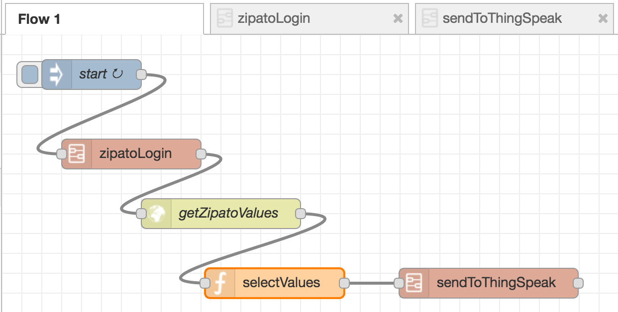

I'm liking Zipato controllers more and more. I work with KNX and I want to start work on IoT too. I found a program image in Node RED with a Zipato pallet
