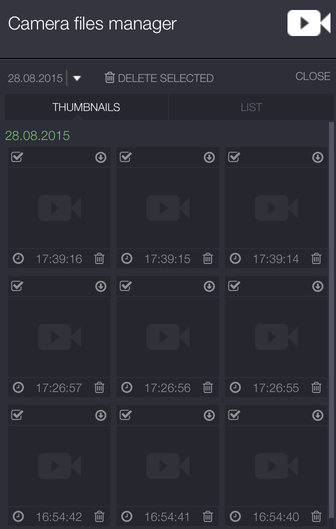

I did as well (meaning in the Foscam Software) however nothing is stored on the FTP server via Zipabox rule although the Foscam software shows that the connection is fine ("success"). Scheduled recordings set in the Foscam are stored on the FTP server. I can see picture in Zipabox's control center in the camera settings (see attached pic) however. I have synced everything multiple times of course.
