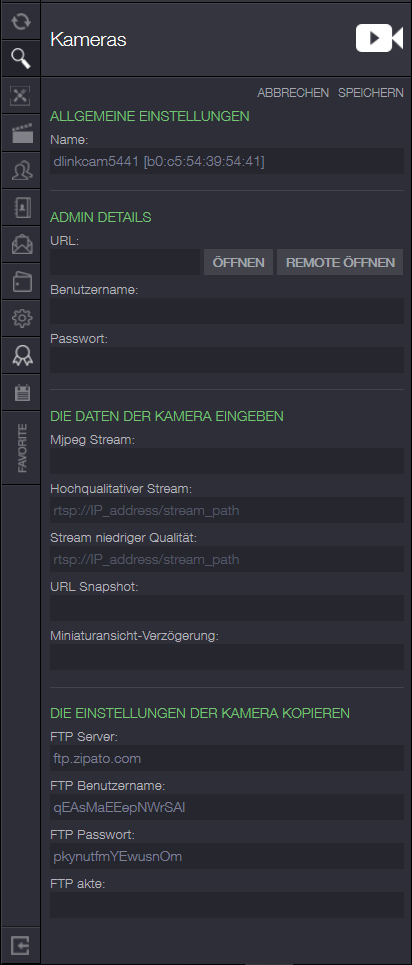

Hallo,
I add a IP Camera on my Zipabox, but i don't get a picture on app.
Where is the problem?
Is there a mistake in the attitude?
Can you help me, please?
The IP Camera is: D-Link DCS-2330L

Fill -> rtsp://[USER]:[PASSWORD]@192.168.1.100/live1.sdp at Hi quality stream in edit camera information screen. (use your own settings ;-) )
See also https://www.ispyconnect.com/man.aspx?n=D-Link# for more camera stream settings.
