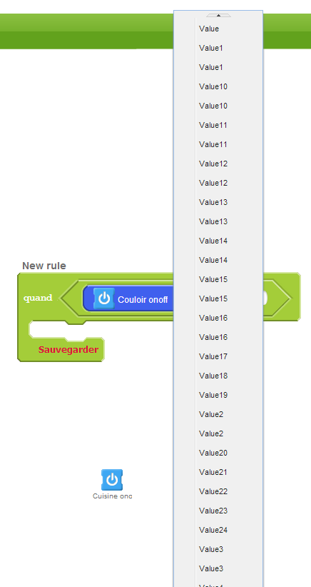

When I add the Aeon Labs smart energy, that's what I have (attached file)
I don't know what are each value.
This dimmer measure power, maybe one or 2 values for that... but there is many more than 2 values.
Ok, your device was not fully supported. Now we added support for it (you will see it as "Dimmer with meter"). Try now to create your rule.
