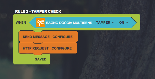

I've successfully sent a mail and push notification (Pushover) when tamper on Fibaro FGMS is triggered. if you want trigger a siren it's enough change the send message with an action puzzle
