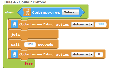

the thing i want to do is to activate the light during presence in the room, and after 2 min stop the light.
Does is it right that the JOIN stop the old execution ?
in attachement , my rule simple rule for activate à light during and stop after 2 min if no more move, is it OK ?

I had place the join after the turn on of the light
my question is if the rules is activate a second time 1 minute after the first one, do the light will be on 3 min (1 in by the first activation and 2 by the second), or only 2 min ( the second rules does run after the join)

I would place "join" before "couloir lumière plafond action"
I think the light will be off 2 min after the rule is triggered first.

I have make test with this simple rule
when run 1 Time the lamp connected to the on/off switch stay ON during 10 Sec
After, i toggle the virtual switch (in the when) every 5 sec, and the lamp stay on. The lamp goes off 10 sec after the last switch.
So for me the Join kill old instance of the rule and only the last one remain active

Intressting, since I have always received the feedback from zipato that join locks the rule from being executed again. In this case it seem like the join is wo affect. Any difference if you remove it?

indeed but the rule seems to restart even upon new toggles, since the light goes of after last toggle and not first. Right?

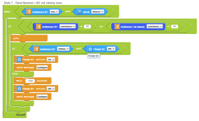

Here is an exampel how to light a room if a precens in the room, but only if the alarm is disarmed and the light insiede or outside is low.

yes the rule restart and the old is stopped.
