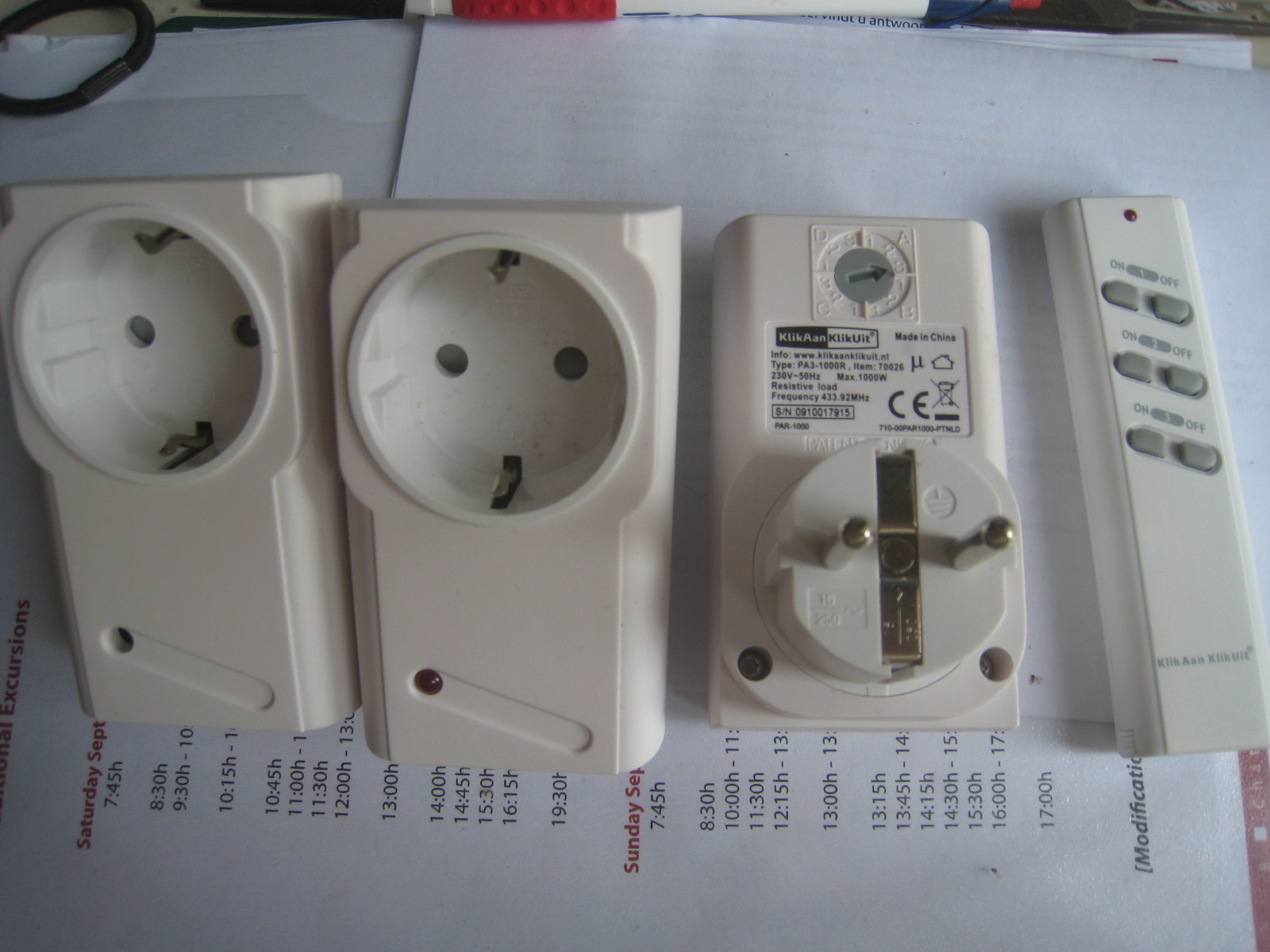

As Zipato is supporting KlikAanKlikUit i bought a 433Mhz module. After installing the module it appeared in the control center.
I tried a bunch of options but I can't seem to connect the switch. How can I succesfully connect my old KlikAanKlikUit to my Zipabox.
Please let me know what to do.
Replies (2)
You can try to add the device as Chacon or Nexa brand in stead of CoCo. E.g. i have a few klikaanklikuit awst-8802 wallswitches which don't work. I added them as nexa lwst-602 switchs and that works fine.
Thanks for the response, I tried a bunch of Chacon and Nexa modules. The problem I think I have is that it doesn't have an inclusion mode. These module as on a fixed channel that is set bij switches on the back of the receiver.
I've added a picture for reference.
So the question is are these modules compatible with Zipato?
No, these are not compatible. Currently only CoCo devices with learning mode are.
