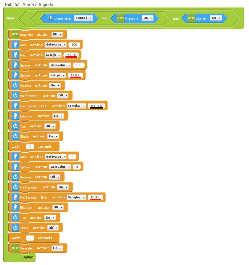

Hello, i need some help whit a rule. i like to use my zipato RGB bulb as a police flash light in case of a trip alarm state.
i like the bulb to go from blue > white > red etc. in a continuously loop.
what do y have to do to make this happen? this is not working:
I have created 2 extra virtual switch for this.
One i turn off and then on and the other to turn everything off (not repeat)
can you poste a example?

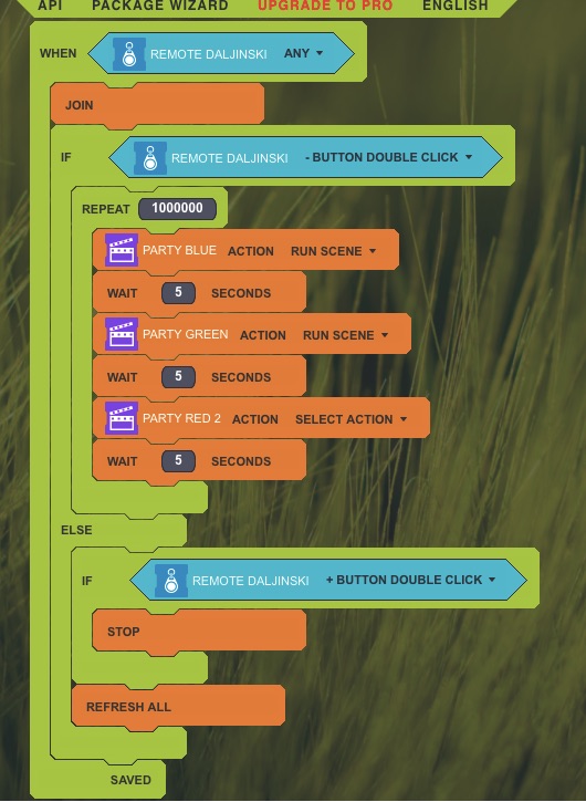

Here is my rule. It will give you rgb color changing and you can decide whit what you are trigerring and stoping.
