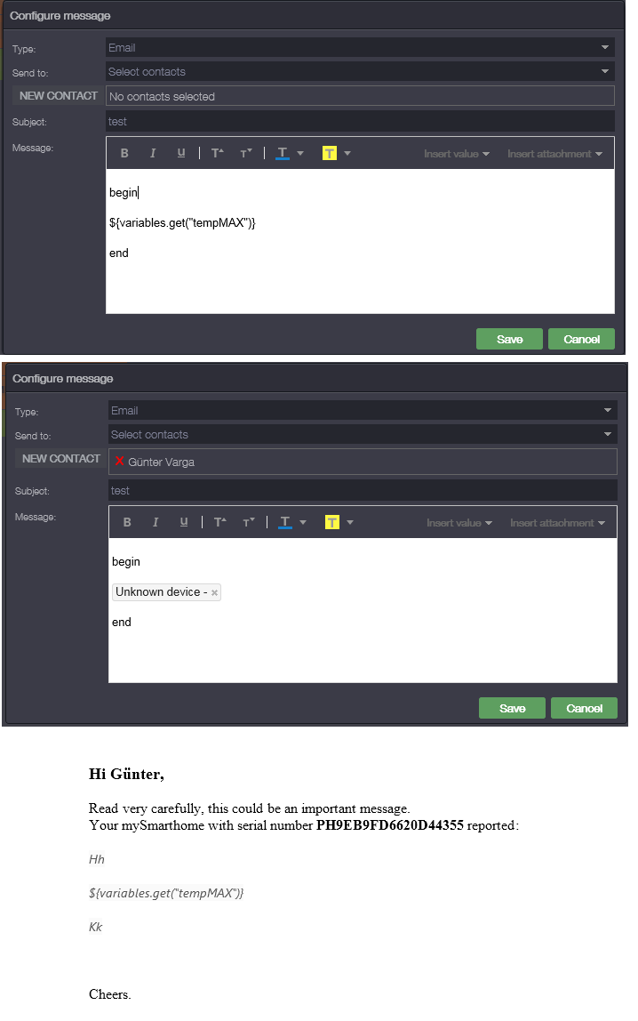

i bought today premium services for 1 month,,,but if i try to add variables to messages i received only
a string like ${variables.get('isDay')} instead of the real varible value...
why? thank you.

previously variables in messages was only a premium feature to get a nice UI. Under the hood the system still could use variables in messages if you knew how to enter the syntax. Now this seems to have been taken away from us unless we purchase premium.
Correct?
I bought Messages PRO with 59 Credits but I'm still not able to enrich emails with variable values or sensor properties. The email only contains only a string like ${variables.get('myVariable')} instead of the real varible value... The support says this is a known bug. For what then I payed 59 Credits???

Theres a bug, sry, Zipato for the late bug report...8)
You just need to replace single pings with double pings (' -> ")
  1. ${variables.get('myVariable')} has to be ${variables.get("myVariable")}
That goes for everything in the variable string...:
  1. ${attributes.get("9201d5cf-0f5d-4fd9-a3c2-1bc23ff41251", "com.zipato.cluster.DoorLock", "state")}
That should fix it for you...
thanks Jasper, but it did not fix. How did you test it ? I attached pictures:
1. configuration before pressing SAVE
2. after re-opening the mail-configuration (why "unknown device") and
3. the received mail.
