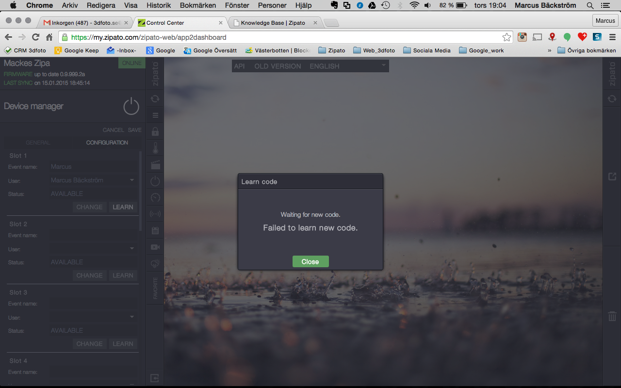

Hi, i´m starting to believe that there is something wrong with my mini keypad.
The Keypad register ok on the zipabox, but i can´t register the RFiD-tags.
When i click on the "learn" button to register a tag, a popup window shows for a second, saying "Failed to learn new code". Then a countdown for 30 sec starts saying "Waiting for new code".
I can´t get the keypad to work without the tags either.
I have read nearly everything in this forum about the keypad, but i can´t get this to work.
Can anyone please help med with this.

Old thread i know, but just learnt something - if you're trying to configure the users and learn PINs and RFIDs, if it seems like it's ignoring you, it's because you're trying to learn the same code it already knows. To prove it's working, learn a new code, then relearn the code you want.
Dear Marcus,
The message "Failed to learn new code" error most frequently occurs when you try learn already learned code on the same slot. Therefore, you can try what Steve recommend or perform learning code on the unused slot.
But, if your issue repeats open a Ticket at support.zipato.com and provide us with the serial number of your Zipabox so we could examine your issue.
