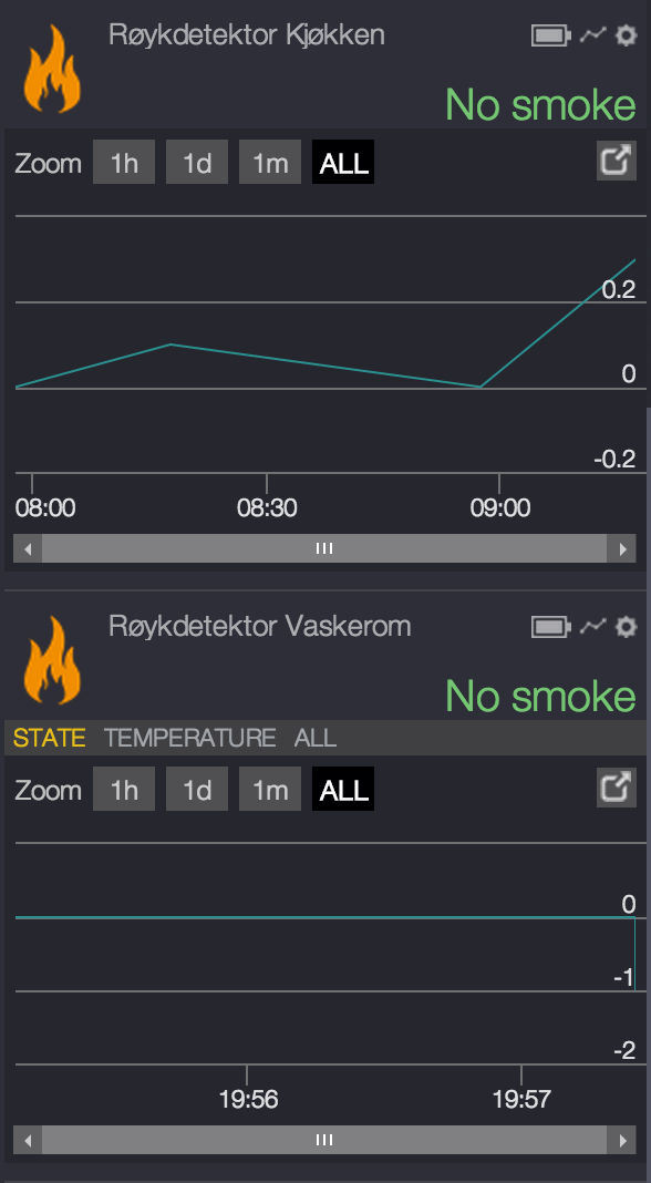

            Hi!
Im missing the state on one of my smoke detektors. See picture. This detektor also makes a sound somtimes..

I think I have the same problem. I think that there is some problem with the communication or state or similar.
The beep you hear is probably that you are running out of battery in the device (mine drains batteries as I drain beers a hot summer day).
In short, I do not trust the state declared in the zipato gui (it sometimes says SMOKE DETECTED while the smoke detector it self is quiet and does not flash or similar). I THINK that this also renders in an accelerated polling of the device that keeps it online more or less all the time (not only wakeup every 7th minute). I bought my smoke detector a few month back and I am already on my third battery...

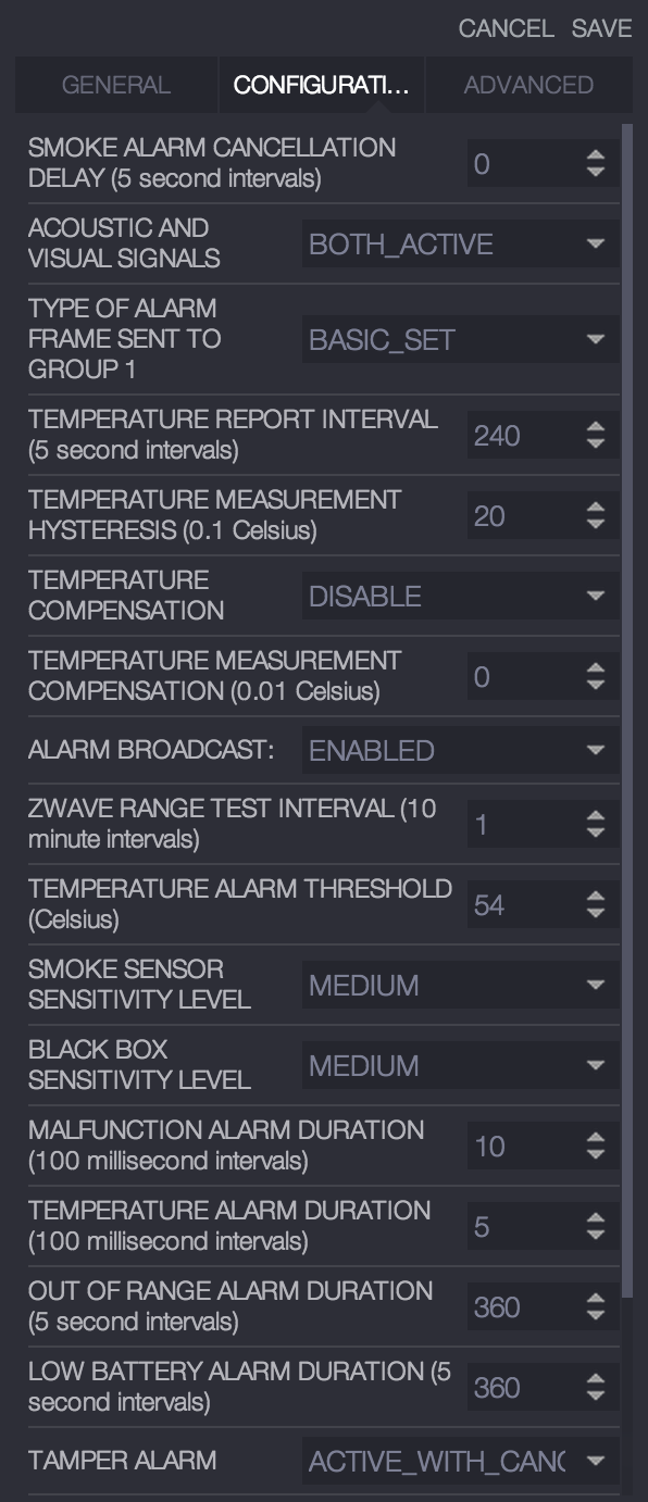

Same here I have 2 pcs running with 12V power supply, and otherone is beeping once a while and the otherone not so often. But Third one is running with battery and just fine and not beeping.
I tried with sensitivity setting with lower sensitivity without any luck.
Is it faulty Fibaro or incompatibility on Zipato side?
