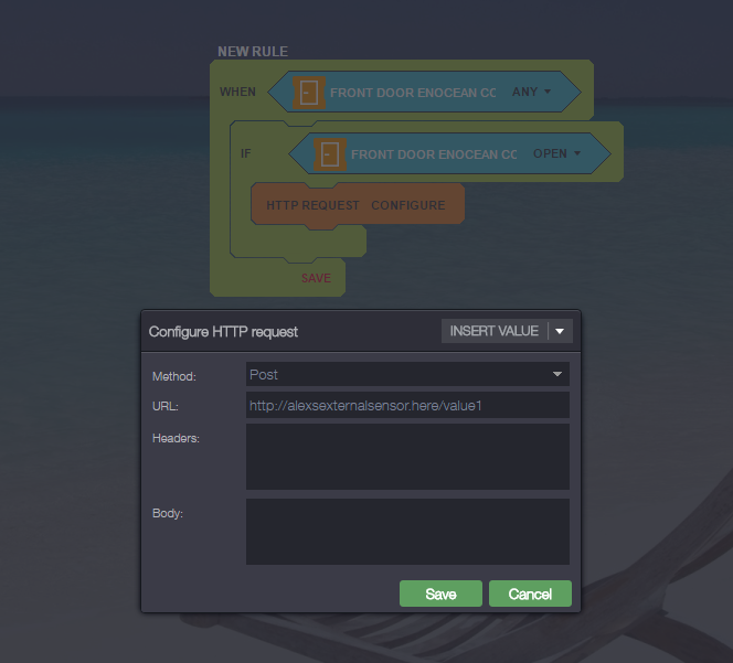

This is indeed possible: You need to create a rule which is triggered on motion detected. Inside this rule you have an action which calls the URL.

Alex just do this with the rules, see attached.
