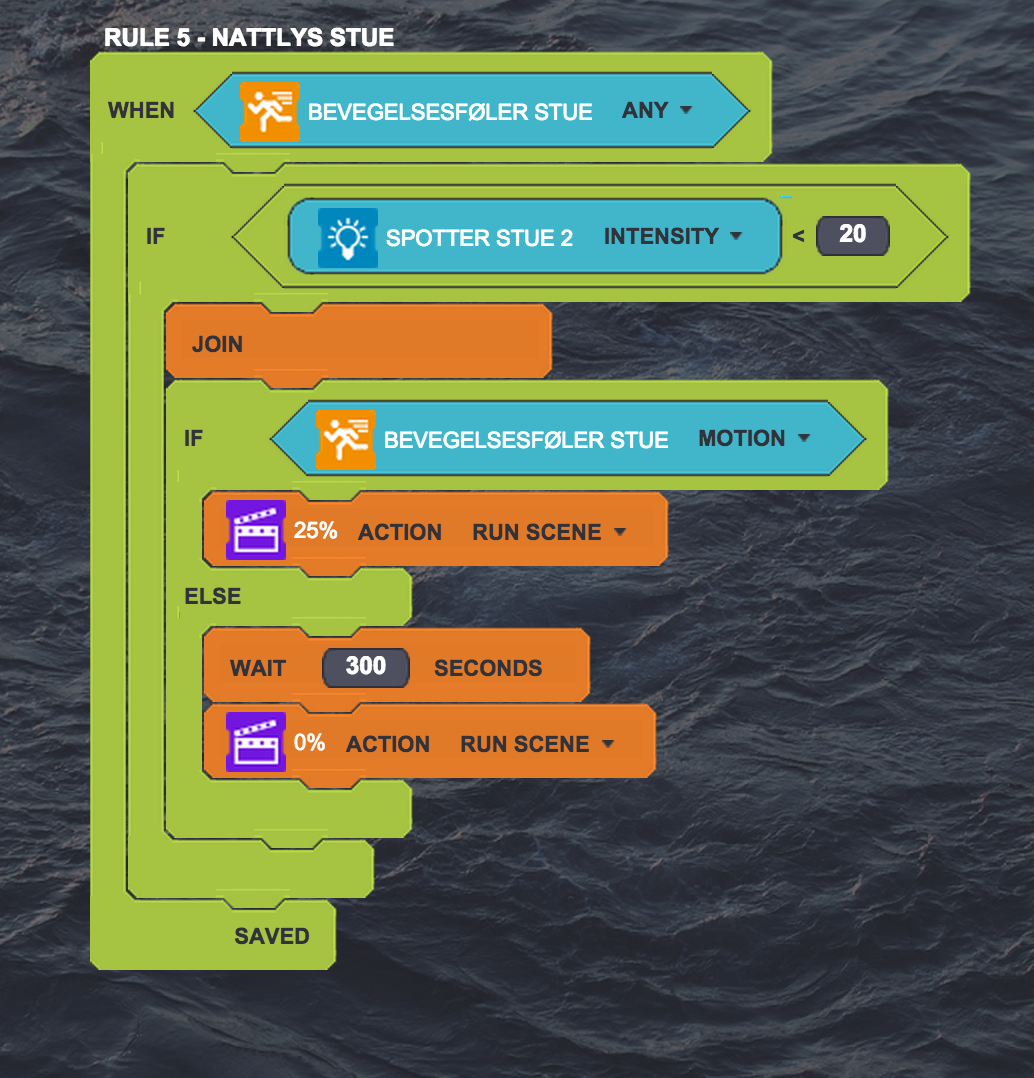

My motion sensor turn on the light if the light is less than 20%, but it does not come off after 300s
See rule picture..

Try to substitue the if then else by a simple if then with the actions:
1: dim 25%
2: wait
3: dim 0%
Your rule does not work when you close the door there is no motion whatsoever so your rule is not executed.
