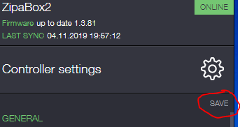

I have just purchased a ZipaBox2 (v1.3.81 firmware) having previously not had success with MQTT on ZipaTile and ZipaBox (except inbuilt sensors) . I was recently told at a trade show by Zipato that support was much better now with ZipaBox2 or ZipaTile2 for fuller integrations.
I can connect to my MQTT broker fine from ZipaBox2 and I have created some virtual devices on the ZipaBox2 but it does not then subscribe to any topics on the broker so obviously no control is possible. Why is this ? Do I have to enable these devices for control from MQTT so then subscribes are set up ?
Should these virtual devices somehow show here under MQTT as devices on MQTT ?.. created via the MQTT device auto inclusion ?
I have for example these showing here and have used the lowest device uuid
I'm very familiar with MQTT but obviously the ZipaBox2 must subscribe to specific, wildcarded or even the root topic or nothing could possibly be controlled via MQTT ...
