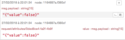

I use node-red to send MQTT to Zipato and it works like this:
msg.topic = "request/attributes/"+msg.payload.attributeId+"/value";
and the payload MUST contain only "value" attribute. So third line you've tried actually works in my case. Double check if you haven't missed something. But if your connection in fine, and attribute type is boolean, then it works. Maybe you want to set a number attribute (like Meter attribute), then value must be a number.
EDIT: As I can see, Bevywise can show subscribed topics for connected clients, so you can verify what topics Zipato subscribes to.
yes your third line should be ok.
See my post before: "I publish with this topic only: request/attributes/uuid/value and the message for example {"value":55}"
And be careful to choose the correct uuid of the virtual switch, it's the lowest in the hierarchy.
I have the same issue, for example when i use cloudMQTT. On change status of virtual, i see on the console:
/zipato/attributes/XXXXX/value{"value":true,"timestamp":"2018-02-26T13:06:34Z"}
But if i tried to publish with this syntax:
request/attributes/0ded8ce4-XXXX2b5b473f/Valuetrue (or json ssyntax)
Nothing appened......

if you have a idea, the publish value with node-red
26/02/2018 à 22:33:14node: b9e9ea2d.e2b2b8
request/attributes/0ded8ce4-fa2f-4b9f-bc06-XXX/value : msg.payload : string[15]"
{"value":false}"
Thx

hi,
I take a capture the first item is the output of the function and the second on the node MQTT output
No affecte to the zipabox
