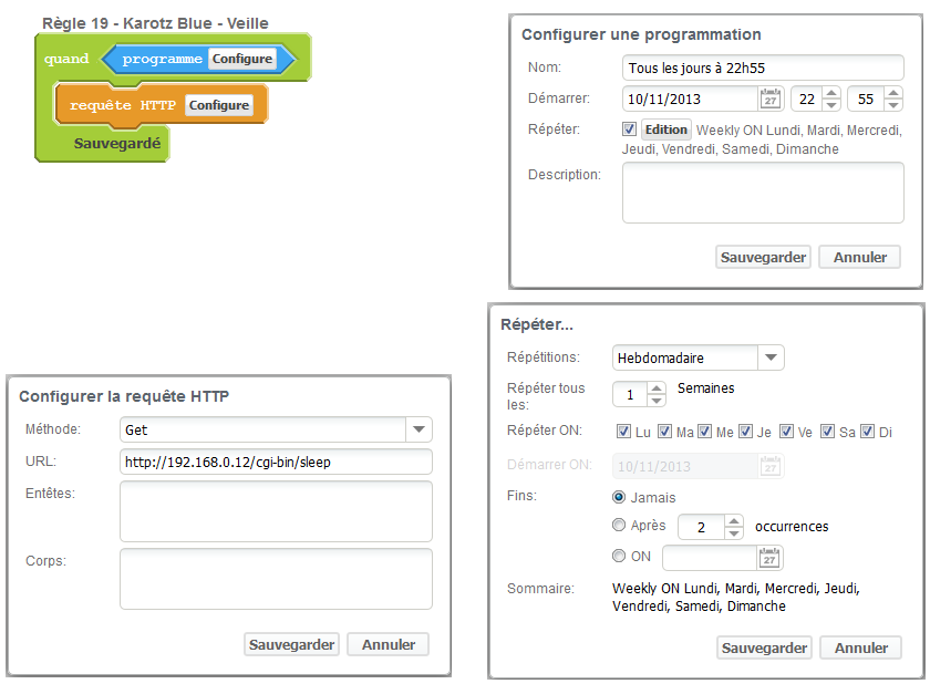

Hi Heros,
Here are my rules.
The first rule is the first rule that I have doing with a scheduler and is OK. It does an URL request hourly to do the Karotz saying the hour with Open Karotz.
The second rule is to do the Karotz sleeping at 22h55 dayly and it is not OK because it is making sleeping the Karotz at all hours (like the first scheduler).
Kind regards,
Benoit DF (fr)

Did you create a totally new rule for the 2nd one?
Or did you use some parts of the 1st rule and then modify them?
As tu réutilisé le capteur "programme" de la 1ère règle en le déplaçant sur la case WHEN de la 2ème?

Hi HeroS and Thomasfr,
I deleted all my rules with the scheduler and I have recreates them without taking pieces of other rules and they looks OK now.
Thank you,
Benoit DF (fr)

I found out that there is a bug when you take a scheduler from a previous rule.
It keeps the same settings even if you modify them.
Great to hear that your rules now work properly!
