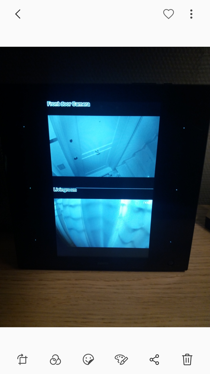

I have 2 nest camera's, and the Zipatile can not work with the Nest app unfortunally :(
I download the APK of the "home remote" app.
Install it on the Zipatile, and let the app search for the Nest cams.
The "home remote" app can show multiple cams at the same time.
Then I made a rule, if someone press the doorbell, the Zipatile screen goes on for 1 minute, and also starts the "home remote" app.
On-screen in a few seconds

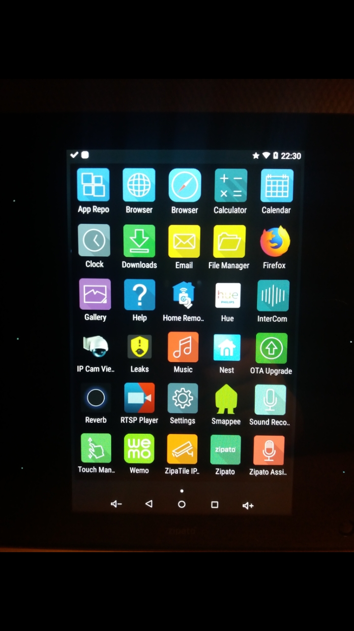

Sorry, the app is called "IP cam viewer" It's working for my 2 Nest cams.
The home-remote app is also working, but not multiple cams together on 1 screen ;)
Here the logo of the "IP cam viewer"
The 4th row on the left
