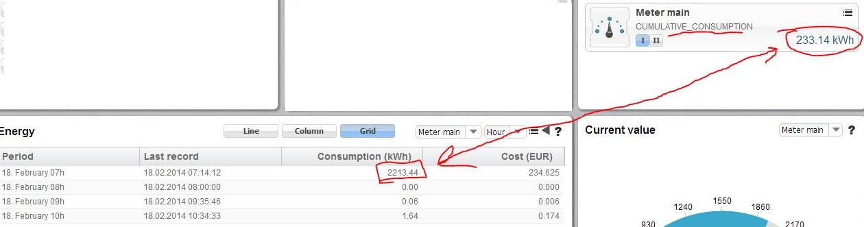

I am experiencing exactly the same issues with completely wrong values on one of the three clamps.
I have tried with removing the device, then DELETING (this removes old data) it from the device tree in the dash board and then resetting and joining back the meter but it seems to always START with a completely wrong (and too high) value.
See attached screenshot.
