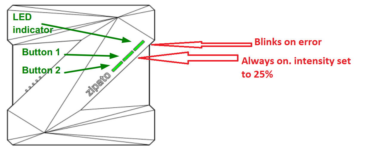

but I did notice. the notification led is led indicator on the zipabox(that is the led that is blinking when there is something wrong). and the led that is dimmed through the menu is button 1 (power on led?)
previous status:
leds where completely off. nothing on.
when I disconnect my network cable, the box starts blinking green (led indicator).
new status:
button 1 is always on (changeable through GUI and set to 25%)
previous status:
new status:
Rather confusing now. Today I did some experiments.The led indicator is always on. However in my case is button 1, in normal operation, never on.
When i plugged out the networkcable the following was happening: the led indicator starts blinking and the button 1 was going on. When I plugged in the networkcable button 1 went off and the led indicator was not blinking again.
So what is the real story for button 1?
