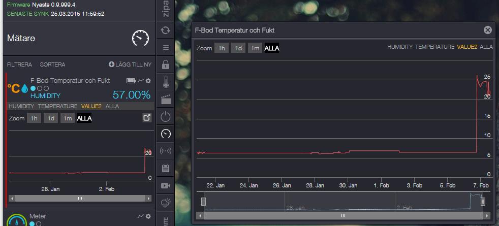

its show
Humity
Temperatur
Temperatur
or in the computor show
Humity
Temperatur
Value2
se attash file from the computor
Value2 = a temporary testing of the meter Ever Spring ST814,
which I performed indoors in the main building, hence the high temporary temperature.
