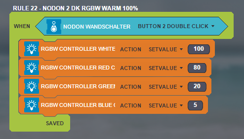

You cannot create a rule in the new UI setting individual levels (0-255) for the RGBW channels for the Fibaro RGBW controller in the new UI. It looks like you can set it in a hex string, but if you do so, the rule is not possible to save. Hex might nog be completely user friendly. I am an IT Professional and can handle that 0-255 Dec is = 0-FF hex, but for other, this is hard.

you can create rules in new UI for control every individual level for every color for RGBW of fibaro. You have to make visible the single colors for rule creator. I am working with that everyday. The NodOn works fine with me also in routine. Which FW do you use. I use ...m. I have attached my rule for Nodon Wall Switch steering the Fibaro RGBW controller.
