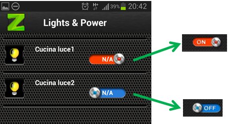

Hello, somebody can explain me why in my app the virtual switches for lamps have N/A label instead of On/Off? (see attached file)
Thanks a lot for any help

Can you send a picture of the Virtual switch setting?

Hello Kristian, please find attached the screen copy of device config

It could be,....It's what I'm looking for . The device is Fibaro FGS221 - v2.1 and it is is declared compatible in Zipato site
Instal this on:
http://files.zipato.com/Zipato_2.0rc12.apk
(if you have android)
The Fibaro should show true/false

Thanks a lot HeroS, now I can see true or false states intead of n/a (not available I think...) for both states and also the lamp icon changes from transparent to yellow... now it's better! thanks also to others who tried to help me....now I go ahead with my experience on Zipabox. Ciao from Italy
