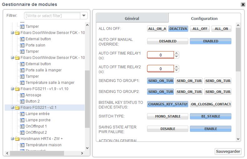

Now the problem, it's about the AUTO OFF TIME RELAY 1, and 2. My aim, i want just change the SWITCH TYPE to "bistable". And when i click on update button , it's impossible because the "0" value in AUTO OFF TIME RELAY is not allowed, i have to put value different of zero...what do you think?
Ok it's very clear, and it was important to know that.Thanks.
Same as Vincent, 0 is not allowed in both relay boxes as on image here
