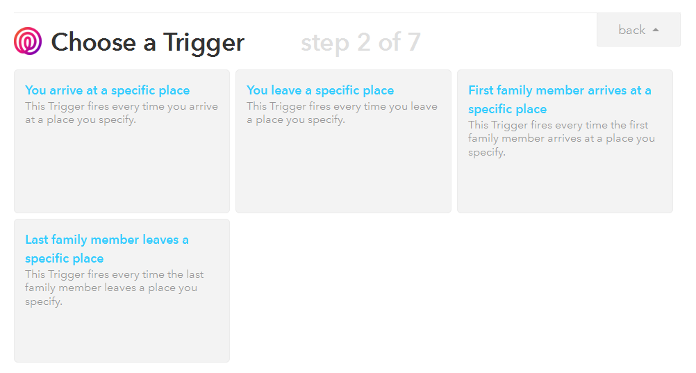

Download LIfe360 for all your family members; it's free. Get an account at IFTTT and connect LIfe360 to IFTTT. You can then build a recipe on IFTTT which triggers a rules in your Zipabox to do something when the last member of your household leaves the house, or the first family member comes home.

For some reason Life360 is very accurate and works flawlessly on both iOS and Android. It *does* let me know when people leave the house and when they get home, and so far I have only detected one miss; that happened when my wife had turned off mobile data and the app simply couldn't send...
I recommend you try this app.

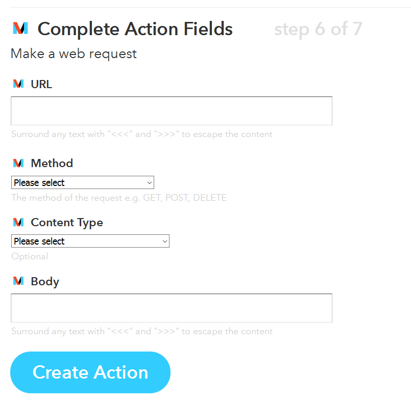

I made "Almost" good solution using IfThisThenThat (IFTTT) And the channel "Maker"
When I disconnect my homenetwork It runs a webrequest (GET) for a Virtual Sensor in my Zipabox
And when I connect to my home network it makes another webrequest.
Almost no batteryusage on the phone.....

Enclosed are IFTTT examples of how Life360 can trigger when someone (or first or last person) arrives or leaves a particular area, and of MAKER which can be used to trigger Virtual switches in a Zipabox when the specified event takes place.
