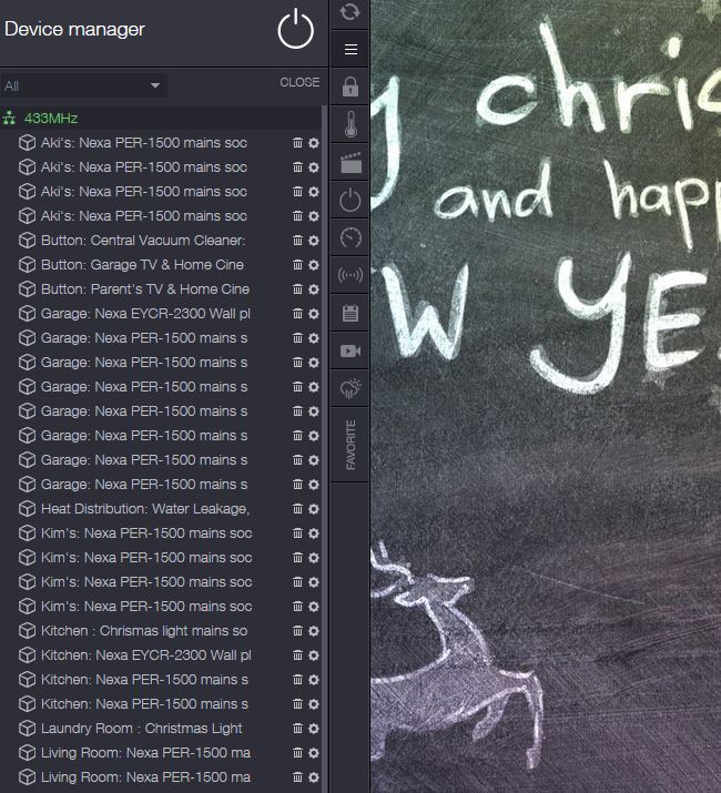

Yes, I can add devices. But not switch on/off.
I have a lots of Nexa PER-1500 and I have Zipabox Duo ( Built in 433Mhz module ) and yes I also have Telldus live ( which now, after Zipabox installed, just reading some unsupported by Zibabox Viking temperature readers which I have at every room http://www.teknikmagasinet.fi/tuotevalikoima/koti/lampomittarit/viking-remote-thermo-sensor ).
I do not have any problems to switch off or on those plugins on admin mode or trough Nexa Wall switch ( binded ) or trough PC web page or trough Adroid app.
