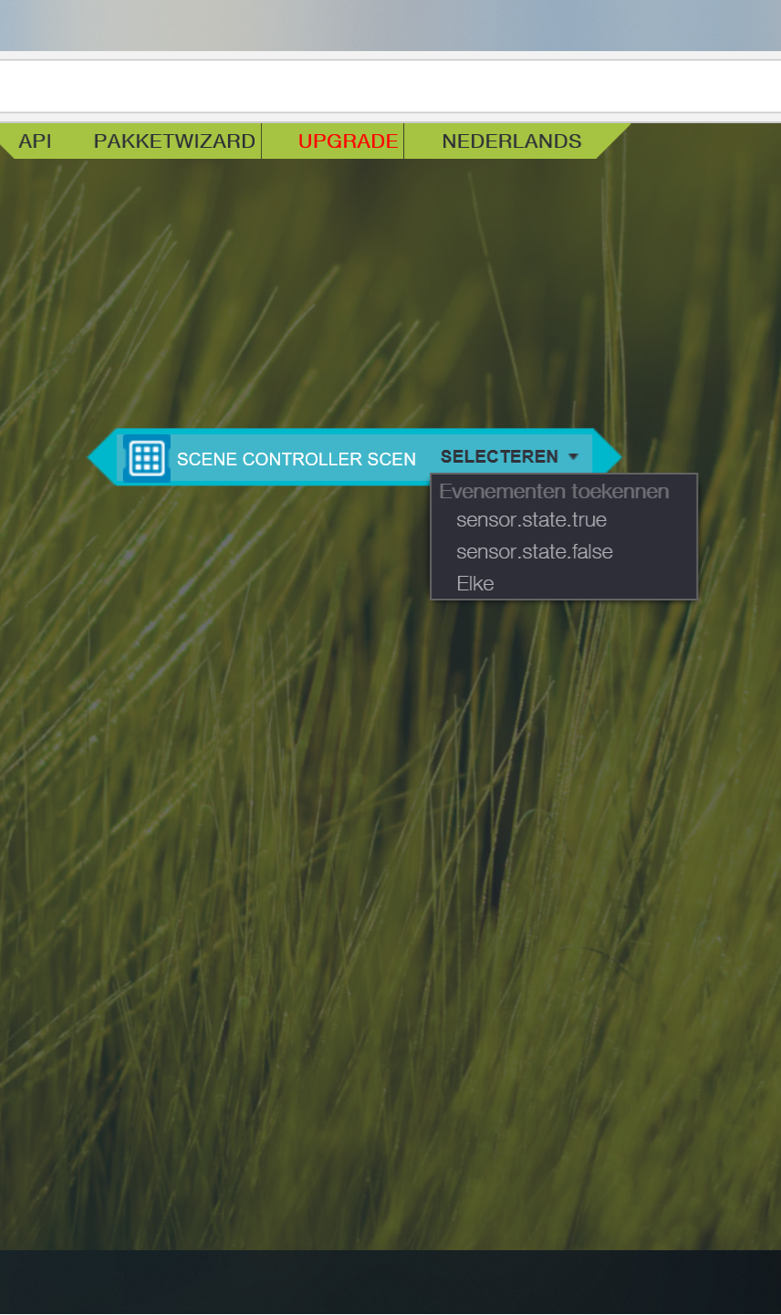

HalloI have bought a ZRC-90. The inclusion process was successfully and the device manger recognizes it as ZRC-90. However, when i create a rule and want to address one of the button it does not work. I am not able to choose among button 1-8. Instead i only can choose among the options: sensor state true or sensor state false.
What I am doing wrong?
Do someone have an advice?

Thanks for your reply. I'm having the same problem. I can't find the buttons located under the "control" menu. The ZRC-90 is located under the "activator" menu and shows as seen in the attached file.

I had the same issue but after installing the Beta Firmware it works :-)

Are there any news regarding this problem? At my interface it still looks like on Sake Miedemas picture.
Maria, if you follow the comment of Alexander, you will succeed. If you use the Beta firmware first and install the remotec (-s) you can go back to the original firmware afterwards. Good luck!
