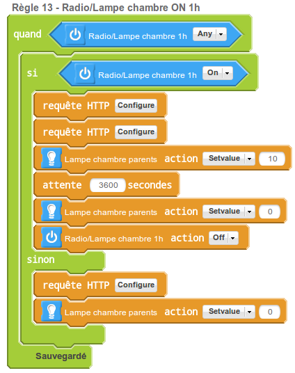

Again, this night I have turned on this virtual switch "Radio/Lampe chambre 1h", so the rule 13 has started his execution but she has never execute the actions after the wait of 3600 seconds.
So I can't trust rules, this is very damaging!Could you look at this please?
I want to clarify that this rule 13 worked fine yesterday night.
Rule 13 is joined.
The rule looks ok to me...are the events listed in the events log on the dashboard?
Is the "Radio/Lampe chambre 1h" switch activated in the events log?
Did you try to add some kind of markers in your rule to know when it stops?
Si Radio/Lampe chambre 1h
PUSH 1
requête HTTP
requête HTTP
Lampe parents chambre action
PUSH2
wait 3600
PUSH3
SINON
PUSH4
Tu as sans doute déjà testé tout ça, mais sait on jamais, parfois ce sont des petits détails tout bêtes qui posent problème ;)
