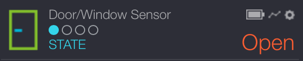

I am trying to include a Fibaro door/window sensor. Followed the awkward instructions and managed to it included.
Efter 15-20 minuts it suddenly looks like the attached photo in the device manager (with state underneath)
Can anybody explain why - and how I remove the state info below?

Hello Thomas,
Does it change state to "Closed" when you open the door??
What is the status of the "Home_Security" button ??
I also have some problems with this senor but I live with the inverted state, Open when door is closed and VV...

Hi Torbjorn
Yes it is inverted. And that really doesn't play well with the alarm.
How do you managed to live with the inverted setup when it is part of an alarm?
I don't see any settings to reverse that in the Zipato.
This is my first non-Zipato sensor in the house. Not exactly the best test case.
