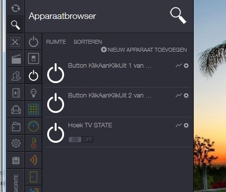

I also have problems with the COCO ( klikaanklikuit ) AWST-8802 . It does appear in the Device browser but whatever I do: I do not see a switch. And I cannot switch it on/off in my device browser..... Anyone??????????
Added screendump
In the screendump (look at attached file) you see the other switch (named HOEK STATE TV) WITH possibility to switch it on or off. But my COCO AWST-8802 is visible but NOT switchable. No On/Off switch
