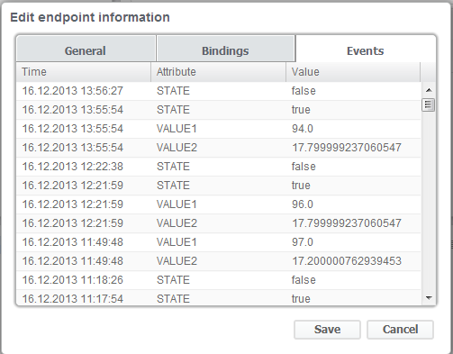

hmz. strange. since yesterday I have complete different events in my ssensor.
before I had temperature, luminance and motion.
not I have state and value1 and value2.
and the meter in the control center is not showing anything anymore.
Same here....they must be working on it.

I have two PSP01 muli-sensors. Recognised by Zipato as two sensors: one motion, and one temperature + luminance combined (why not separate?).
One is the input for a virtual thermostat with a radiator as an output. It worked fine while there was movement, but when people sleep and don't move then it stops reporting temperature and the radiator never gets turned on, and the room gets cold.
How can I force the PSP01 to always report temperature throughout the whole day?
I have more information after contact with Philio and Zipato support.
The Philio multisensors, although they do carry a temperture sensor, are NOT well suited for heating control, such as in a Zipato virtual thermostat. This is because they only send a temperature report at most only every 30 minutes and only if there is a temperature difference >= 3°F (1.66°C).
This is too course for heating control in most situations.
Otherwise these are very cute and well-built miniature devices!
Further, there are some discrepancies between the Philio documentation and the Zipato config page (params, bits). Zipato is looking into this...
Regards, Nick
