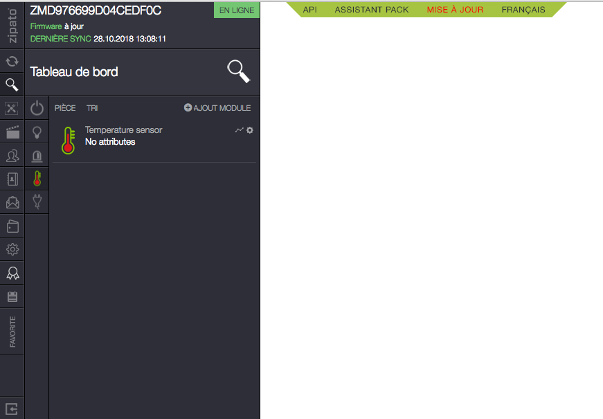

I've the Qubino ZMNHJD1 flush Pilot Wire for my electric heater with a zipamicro.
My temperature sensor is a real Qubino temperature sensor bought 15 euros.
On my dash board it is written : Temperature sensor : "no attributes".
- I've tried 10 times to include / exclude it and several time to reset.
- I've tried to include it automaticaly as soon as connected to electricity and manually
- I've tested with differents sensors and differents qubino module.
No way to make it show the temperature sensor.
Do you have other ideas ? I've bough the zipabox only to control my heater and report the temperature.
