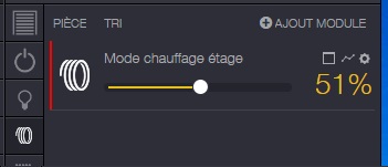

I have the zwave plus version of qubino pilot wire.
I have includ it easily and it work great
But the widget is displayed like a store
It is not easy to use and easy to watch (WAF)
I know pilot wire it is a french specification
but if you can make the widget (and the scene command) with 6 switch : Comfort/Comfort -1°/Comfort -2°/ECO/Freezing/OFF
With this parameters
- Comfort = 51 to 99%
- Comfort -1° = 41 to 50%
- Comfort -2° = 31 to 40%
- ECO = 21 to 30%
- Freezing = 11 to 20 %
- OFF = 0 to 10%
Thank you in advance
