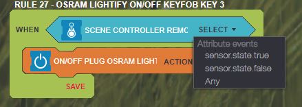

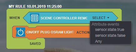

Hello Pedro,
although this is an older thread, I would be grateful if you could help me with this device. I have purchased the Remotec ZRC-90 and was able to add it to the Z-Wave network. When trying to program it, I used the same kind of configuration I used with a Fibaro FGKF-601 controller. But instead of showing me all 8 buttons I only see attribute events.
Could you look in my configuration and help me with this?
Best regards
PS: Node ID:38

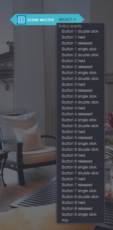

Please install the last beta firmware and exclude and include this device again.

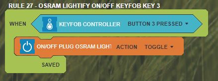

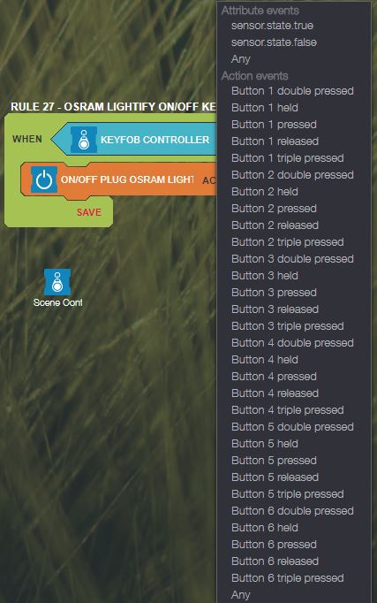

Hello, I installed the Beta Firmware (1.3.44) and restarted the controller. Unfortunately nothing did change. I have attached some screenshots and for comparison one of the working Fibaro Remote.
I hope you can be of assistance!
Hello again, I forgot to delete the device from my configuration. And see, now it is working as described by you! Although your help was useful, I am a little irritated I have to switch to betasoftware. Apparently that is the way to go. I will keep this configuration for future use.
