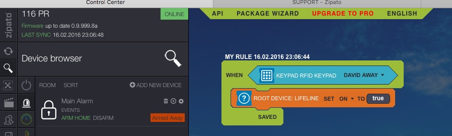

Just an update, I have noticed an entry called 'Root Device Lifeline' it seems to be apart of the TKB device and even has an On/Off state, this does actually work fine, is this right though?

Hello David,
it seams that this TKB socket is not supported so it has a generic descriptor and this is why it is not working in Rules creator. What is the exact model of the problematic device?

Hello David,
TKB TZ88 wall plug is supported but you have a UK version so please open a Ticket on support.zipato.com and send us the serial number of your Zipabox and make sure the device is joined on your Zipabox so we could add support for this version as well.

We added support for TKB TZ88E. Thank you for sending us the required information.
