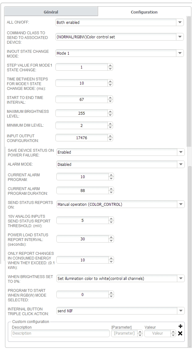

First of all, thanks for your work on the box to integrate the RGBW module. I link a Fibaro RGBW module to my zipabox and I can control outputs without problems (except on android).

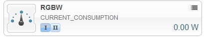

However, I can't view the inputs values in the box interface. This module has 4 inputs where I plugg 2 switches, a thermometre and a light sensor (0-10V). In the section meters of my box's interface, I have only the "current_consomption" and the "cumulative_consuption".
How can I configure the module ?
In attach, a screenshot of my conf.

In my case, I changed the parameter No14 (INPUT/OUTPUT CONFIGURATION) to the value "8888" in order to configure all the 4 inputs as analog. but the light is not reacting proportionally according to the INPUT voltage.

I put "34952" in parameter #14. (4 analog 0-10v inputs) (1000 1000 1000 1000)
I don't know where the values are display, if there are.

I tryed also to use analog inputs. I put 34952 in parameter #14. This is the value in the document mentioned in the manual. See the attachment.

When you configure your RGBW controller to read 10V inputs, the sliders for each channel will actually show the corresponding input value from the sensor. A bit counterintuitive but that's how the device works.
