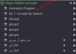

here is a photo of animation program for the last time i found in my archieve
it was with 10 program in user interface and we could use it in rule creator
Hi Merphaad. This is new thing to me? I have never seen this before. Now I understand your question, unfortunaly still not being able to answer.
What Firmware version do you have?
perhaps Zipato has an idea.

Wow, I looked and looked how to use those animations, the only way I could find was by sending the correct value from device manager into parameter 72, but never was able to trigger it from rule creator. I even asked support and they told me it was not supported. Can you tell us which firmware you have and do you remember which firmware you had when you added the device?
I guess if once it was compatible I don't see why cannot be supported agaIn, I find those pretty usable since I have plenty LED strips at home.
