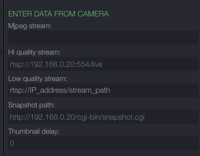

I have setup multiple IP cams on RTSP and they work fine. I am running the RTSP stream on a separated port when streaming. See attachment. So you may have to check your IP cam settings as well to make sure you use the right ones. The player Zipabox is using can stream RTSP without problems.

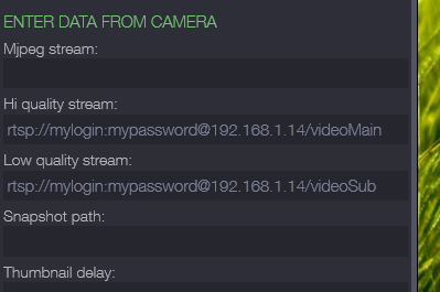

I can't see the stream
it does not work with :
rtsp://mylogin:mypassword@192.168.1.14/videoMain
neither
rtsp://192.168.1.14/videoMain
nor
rtsp://192.168.1.14:554/videoMain
how can I check what's wrong ?

on android i have the error message : streaming launch impossible

Thank you, but the 2 solutions don't work.
With my IP cam, the right way to have the stream is : rtsp://mylogin:mypassword@192.168.1.14/videoMain
I've opened a ticket
