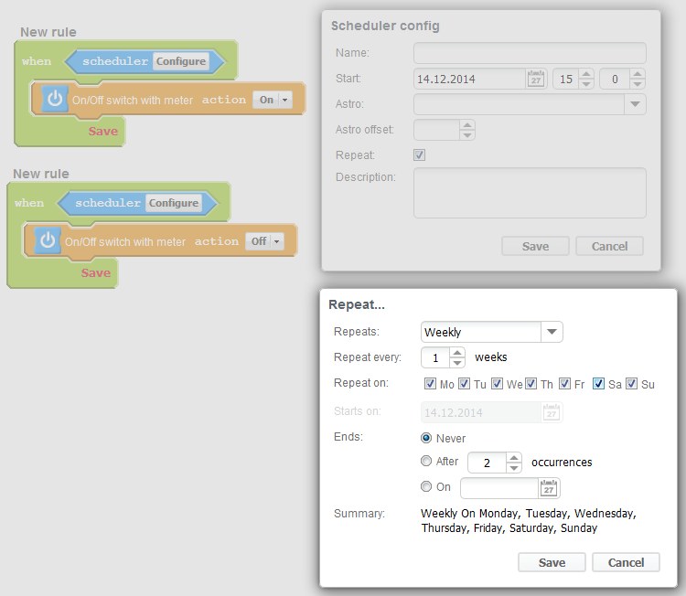

You need 2 different sheduler rules. One for on, and one for off. Attached picture have both rules and start time shedule. Do same kind of sheduling for off rule, set time to 21:00. Then light go on 15:00, and off 21:00

but now everything is OK. work fine on fixt time.
ASTRO don´t work. if i write Stockholm or like in the pic.
the text just disapeare.

You need to create an virtual weatherstation to get sunset and sunrise. Add device and select "virtual weatherstation" in the list.
If you want exact time for on or off just skip the Astro.
