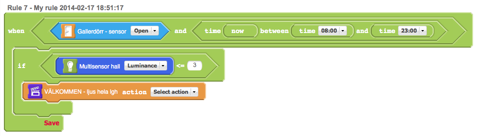

Thanks! I kind of understand how to write the rule in text, but I can't seem to figure out how to puzzle it with the pieces in the rule creator. Is this how you should put it together?
WHEN is ok
but then simply put:
IF (multisensor luminance <= 3)
ACTION
that's it!

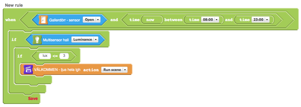

Like this:
WHEN is ok
ACTION
that's it!
Like this:
Like this?
Like this?
If you select a action.....then yes
Yes of course, I noticed a little too late that the action command had reset... but I figured you would see past that.
Anyways, thank you very much for the help. Very much appreciated!

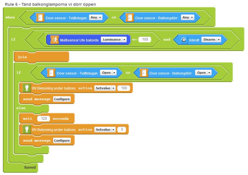

Hi!
Here is an exampel of a similar rule that I'm using.
Hopfully you will get some inspiration :D
Hi!
