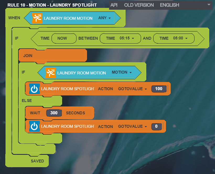

Part of my rules with WAIT function works, but not the part from wait fuction and forward.
In the rule shown in picture (I have six of those "running") the motion turns on the light, but they are supposed to turn off the lights if no motion (WAIT) for xx seconds.
