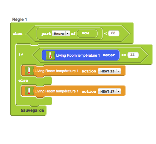

I created a new set of rule as per the image attached. It doesn't work, events monitor does not show any actions relative to setting the temperature.
I use a remotec zxt 120 to control my Heat pump, I checked, all actions work fine (HEAT 17, HEAT 25 etc...)
Screen Shot 201...

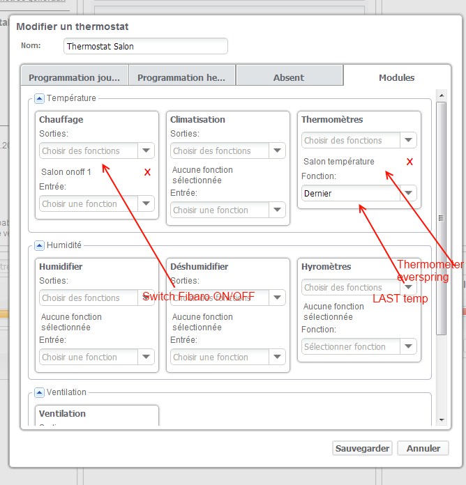

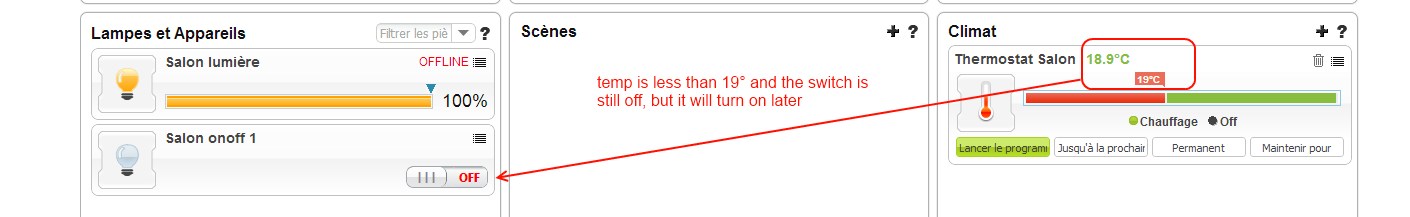

I did it, I had some difficulties at the beginning especially because the algorithm seems strange, the temperature was less than the required temperature and the heating was not on but then when the temperature decrease more it turns on. Watch my screenshots to see how I did it.
This why I opened my question : http://community.zipato.com/responses/whats-the-algorithm-of-the-thermostat. Some one spoke about Hysteris but it is not clear about this, the behavior and its setting!

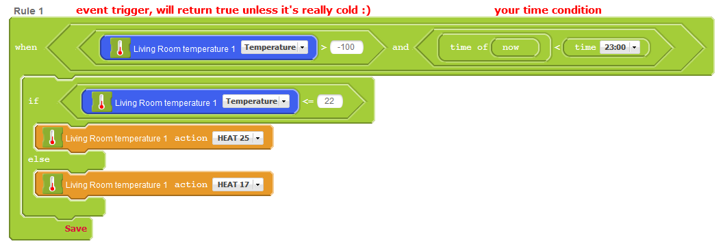

Pierre, your attached rule is invalid because when clause has no event dependancy. We will fix that and in future there will be alert message before saving rule like that.
Look at the attached image to see how your rule should look like.
That's right! Thanks!
