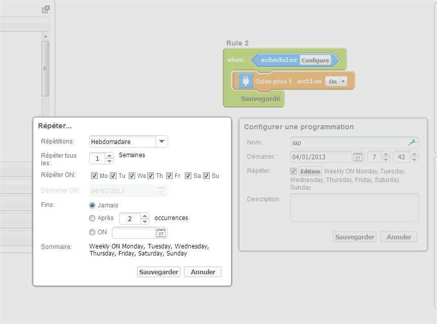

hi i have a problem with rules.
my rules do not trigger...
on the dashboard swith on/off run normaly.

Same problem with sheduler and "time of now betwen time and time"never work.

Hello ChrisDalo, did you pressed "synchronise rules" button after creation of the rules?

Yes, i press "synchronise rules" and i try a lot of other things "synchronise" on dashboard, "reset" on Zipabox switch, use "time of now betwen time and time".
No actions start whem the hour come. Milan has my acces codes, you can see on my box.
The rule with HTTP to send a push via "Pushingbox" do not work too.

Same problem too, reset, or synchronise dashboard and synchronize rules...
it's a very high problem, nothing run at the time.
i test this week with a motion sensor for run a rule...

There was an issue with compiling of the rules, please check if it works now.

hum it's not ok again.
today doesn't work again...
that's going on with the rules?

For me always ok.
Don't forget to "synchronise rules" and ""synchronise" after on dashboard

yes i synchronise rules and synchronise box on a dashbord
but the rules do not trigger...
it's big problem...:(

For me, all the rules're working.
I made rules with Scheduler, Counter, HTTP request (PushingBox), Increase Variable.
I don't have any problemes.

New version is deployed and all problems should be fixed now.

it's ok, I had a problem with a module
all run now.
