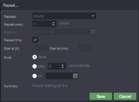

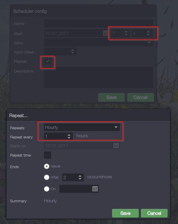

Can you post a picture of the configuration of your scheduler? This is how it should look like...
I have hourly and minutely schedulers and they work fine, however I like them to trigger at whole hours/minutes so never tried the hourly to configure it with minutes after the hour.

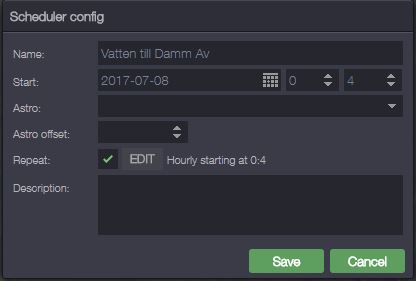

Here are the pictures, I did exactly as you did before and it never worked so I proved that way that didn't work either.
Sad.
All this is very strange as it worked before, I have old schedulers that have a start at half every days, but I can't create any new one that works, any bugs in the new release ( 1.2.29 )?

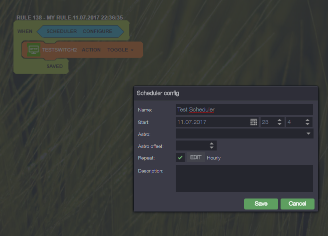

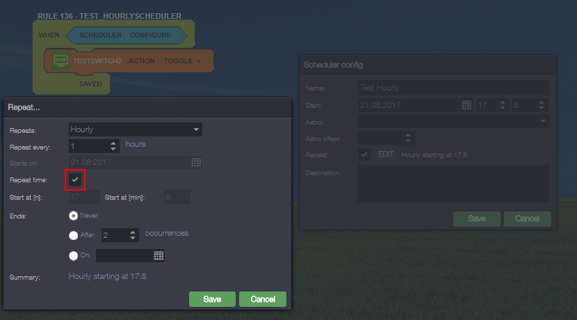

I will make a test rule and let you know my findings...

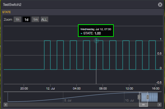

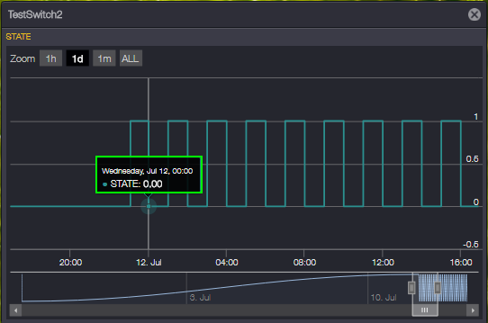

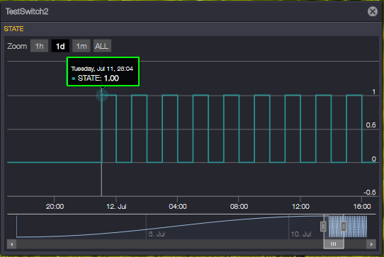

I would open a ticket on Zipato Support, you are right, the first event in the sheduler starts at precise time, after that all subsecuent events are moved to whole hours, see attached.

Yes, they are investigating this issue. However, can you guys check if this option is checked on your schedulers? they told me this need to be enabled in order for it to repeat at precise time, mine is checked but still repeating at o'clock.
