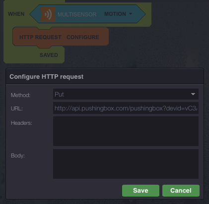

i made a rule with HTTP request, Post, URL=http://api.pushingbox.com/pushingbox?devid=vxxxxxxx but i doesn't work.
I send an Email in the same time, and i receive it.
When i put this URL in Chrome, i receive a notification on my phone.
I try with Post, Get, Put, nothing works.
Have you an idea ?
I added a rule on your box just to see if we're getting the requests, and it looks OK, I see requests.
The URL you've entered is OK for Get request on pushingbox, not Post.

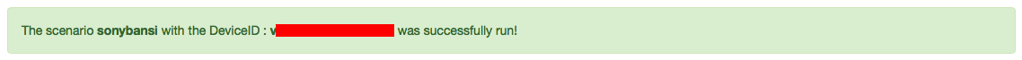

I made a rule with HTTP request, Put, URL=http://api.pushingbox.com/pushingbox?devid=vxxxxxxx but i doesn't work.
Test on Pushingbox virtual scenarios, i receive a notification on my phone.
But made a zipa ruIe HTTP request, tried with Post, Get, Put, nothing works.
Please help me how make a rule (when motion send me notification) which can send notification on my mobile with Newtifry ?
