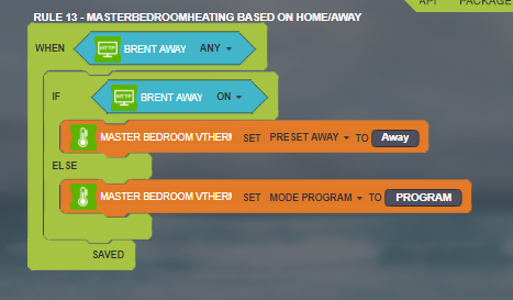

Create a vSwitch Home/Away
Create a rule:
When VSwitch = Any
IF = vSwitch=ON = Action (vThermostat ) Set Preset Away to Away
ELSE = Action (vThermostat) Set Preset to Home
You can each room 1 by 1 to both sections IF and then ELSE
See attached.
