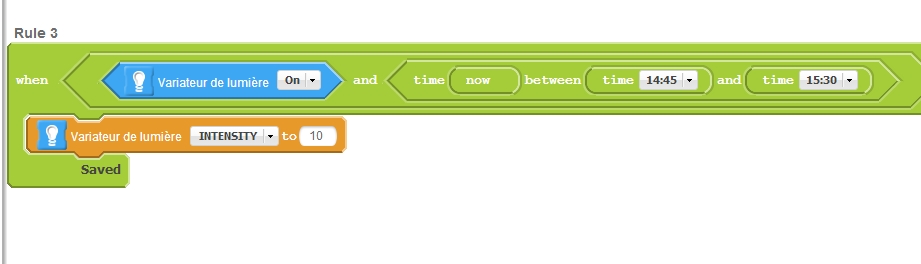

The rule is in attachment
The values are for testing

I don't have the dimmer. But can u not work with a delay and then turn on?
Or turn on the lamp at 10pm and set the valua and turn it off again.
Or when u turn off the lamp set the valua to 15% and then turn it off again.

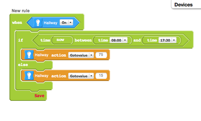

never tried, but like this?

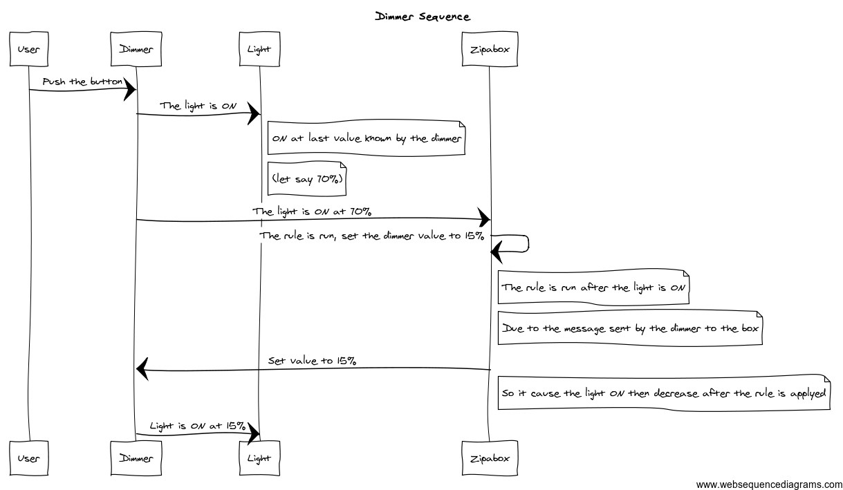

Your solution looks similar as mine, the problem is not about the rules, the problem is about delay; the delay between the user push the button and the rulke is applyed. Have a look to the diagram. The best wold be to send a message to the dimmer at night for setting the night level value and at morning for setting the day level value. But I do not know if it is faisable with z-wave or with these module or with the actual capabilities of the rules.
I used this tool, I did not know it before but it is great and free:
http://www.websequencediagrams.com/#
