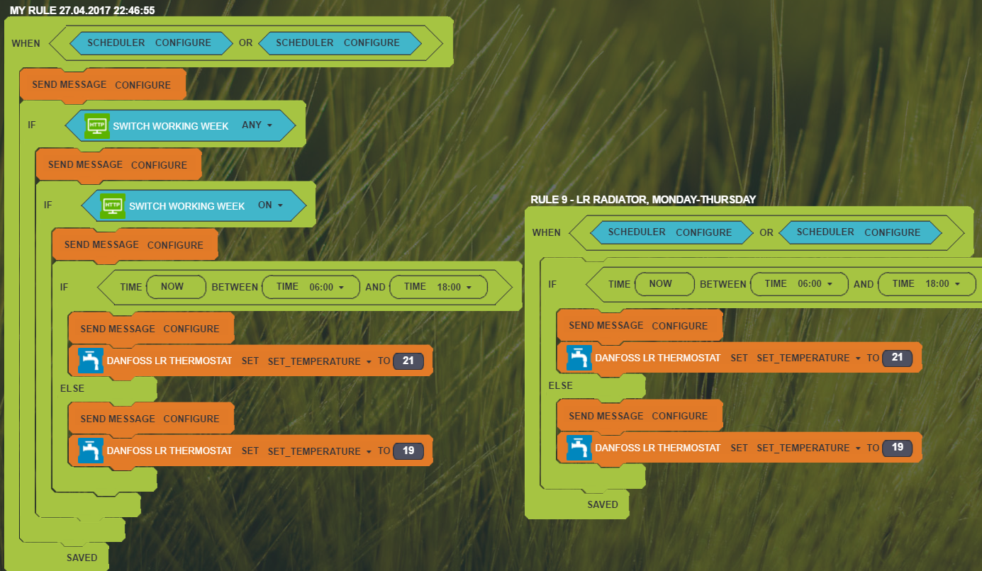

I have different rules for my radiators. The rule to the left working well but I need the possibility to switch it off so I added a Switch as shown to the left. (I need 3 setup: Weekdays, Holidays and Away).
The rule with switch stops at the Schedule. I don't get the "Control message" after the schedule.
What is wrong? (I have tried different settings with Join, Repeat etc.).

You cannot "test" on a Schedule / use a Schedule inside the rule. It can ONLY be used to _trigger_ a WHEN, i.e. at the beginning of a rule.
If you need to "test" based on time you have to use IF TIME OF NOW IS BETWEEN TIME X AND TIME X.

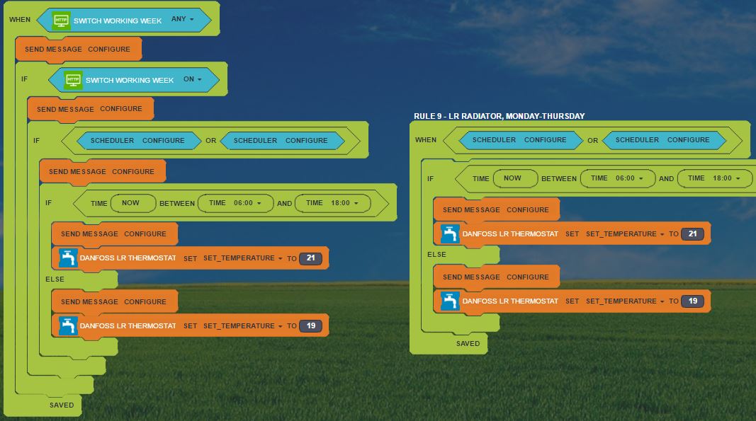

OK the Schedule have to be at the beginning in the WHEN, like my rule to the right thats works. But how do I place a Switch for turning the rule ON and OFF? I have tryed to place it inside the WHEN but it seems get some error (At left in screendump).
How is the best way to switch between 3 different rules (Holiday, Work weeks and Away)?

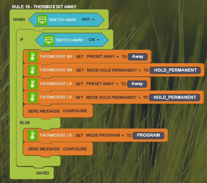

To simply change to different modes in mobile app is not possible as you can change temperature. For mode change you can setup a virtual switch and a rule that would change to away mode if you turn on virtual switch (switch rename Away)
Thanks. I have made this Switch, and it works fine (so far).
The Thermostat AR have another Switch, for going back to normal Program.
I think you can remove hold pernamenet.
@Attila
If I don't have the HOLD PERMANENT, the settings is set to UNTIL NEXT. And if I'm away for one or two days the settings go to standard PROGRAM.
Or do I miss a Setting option?
Surely not. It was an idea. I did not know that without hold pernamenet the setting will go back to schedule at next change. Thx for the info.
