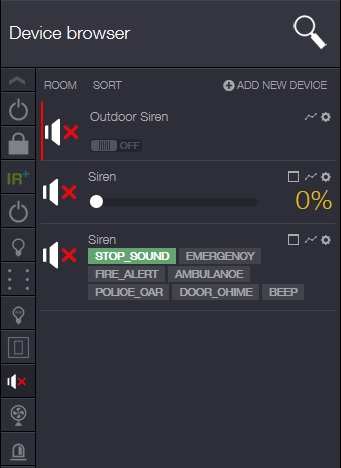

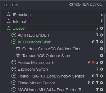

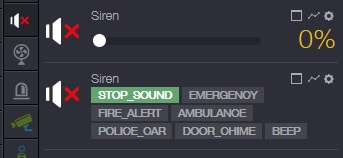

I also noticed that the volume (i may be wrong) of the siren (image 02) is at 0%. I tried to set it at 100% and sync, but it comes back to 0%. Also, the look of our outdoor siren (image03) shows it is off line, but i guess it is because is sleep mode? It may be relevant.

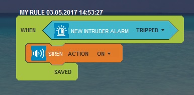

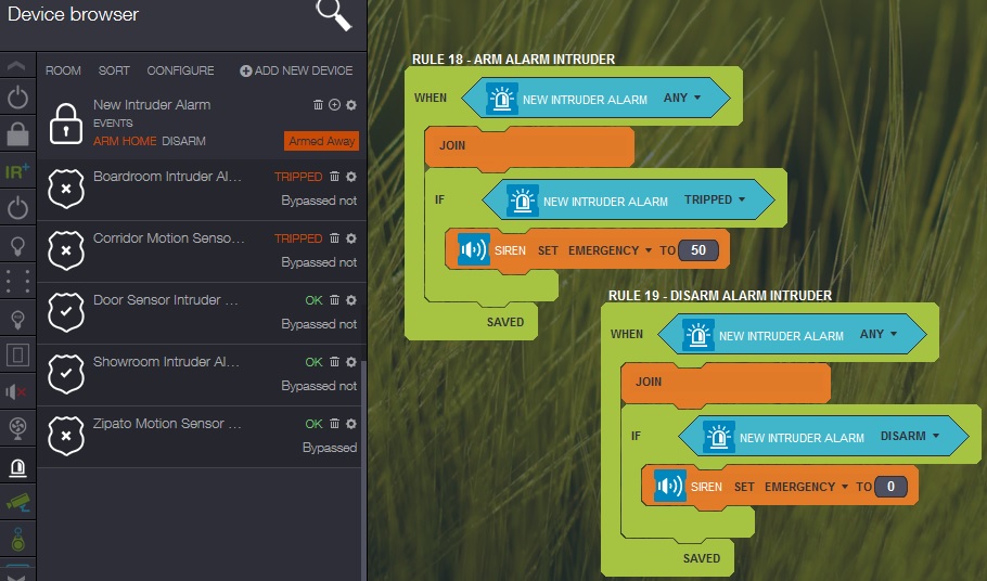

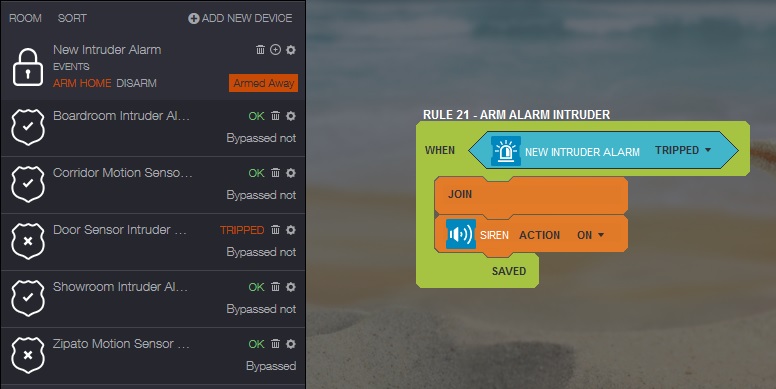

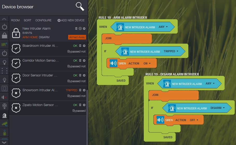

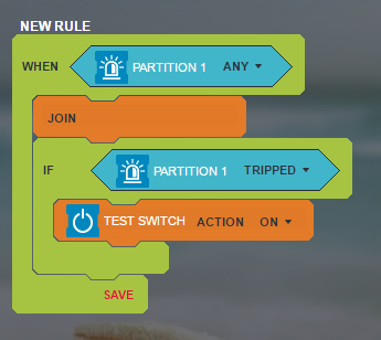

We tried some rules also (image04 and image05), but it doens't work. With the rules, when we set the siren to be activated when the alarm is trigged, it doesn't work. Could you help us, please?"

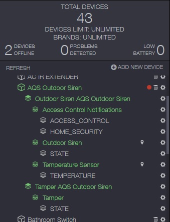

We managed to bring the outdoor siren back online (image06), but it makes no difference, as our main issue is that any device is activated when the alarm is trigged.

This will definitely not be an answer to all your questions, but, the internal siren is perfectly normal to be at 0% most of the time. It changes to 100% when it plays any sound and then back to 0% - you can see it is in stop-sound.

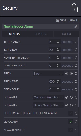

Do you have pro licence? If no, you need to remove any additional siren. you can only have one in the alarm panel. I also don't recommend you using anything else than the siren for squawk or siren as this setting is currently (still) not designed to work with the alarm, although they should - basically you should not use any light or plug as siren or squawk. This requirement should work in rules although you state it is not.

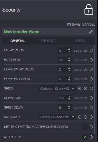

Thank you, we didn´t know about the alarm sound level. We have pro license, but in our tests we didn´t include more than 1 siren in the alarm panel. We are using a virtual alarm, our set up was this (image07). We´ll take out the Squawk from there and add it in a rule.
Thank you very much! We were running out of ideas hahaha. We´ll make some test and see what happen.
As a squawk, you need to replace the binary switch with siren. Siren can be in the squawk device. As you have PRO license, you can use more sirens as Siren and squawk so add both, the internal siren and the external siren. it should work. The only think that comes up to my mind - in order for a siren to work properly, it needs to be an active listener, it cannot be a device that "wakes up" as it will never wake up at the time required. Siren should be active listener.

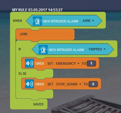

-We took off the siren from the virtual alarm, siren and squawk. Tried with rules (image08, image09). We tried both action and set blocks. It didn´t work.
-We set up as siren the zipatile internal siren only, no squawk. Tried the same rules. Didn´t work.
-We set up as squawk the zipatile internal siren, no siren asigned. Tried same rules, didn´t work.
-On the rules, we change the zipatile internal siren for the Popp outdoor siren. And we tried the 3 steps above again.
It didn´t work either.
Probably my rules are wrong.

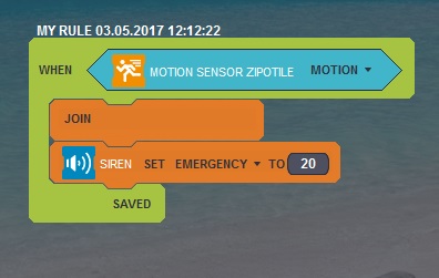

I just did a simple rule (image10) and it didn´t sound. But if i test the siren funcionallity (image11) it makes the sound. I´m starting to doub about my rule skills.
In your latest rule remove the value "20". then reattach the siren and just select one sound. The number will automatically populate and leave it like that.
If no good, then I have no idea
That worked. But what that´s it mean?

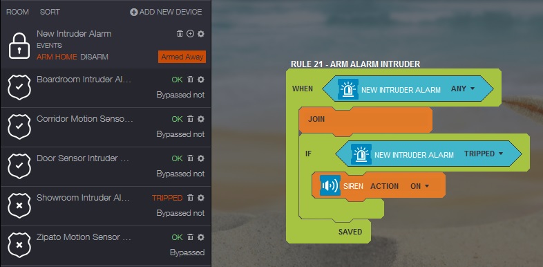

We tried this, but it doesn´t work. (image12)
Try to change in the WHEN block the ARM to ANY.
If no good raise a ticket with support.zipato.com. it should work.

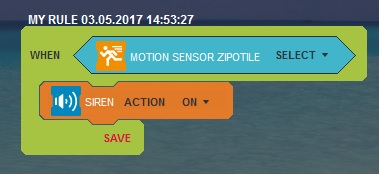

I tried image 13 and it works (when motion selected) but doesn´t work with image 14.
Oh, i tried with "any" in the when block also. I was posting this while i was waiting response for my ticket. So i guess i´ll have to wait a bit more. Thanks a lot Attila.
did you try "any" block then another if and tripped in the same rule?
