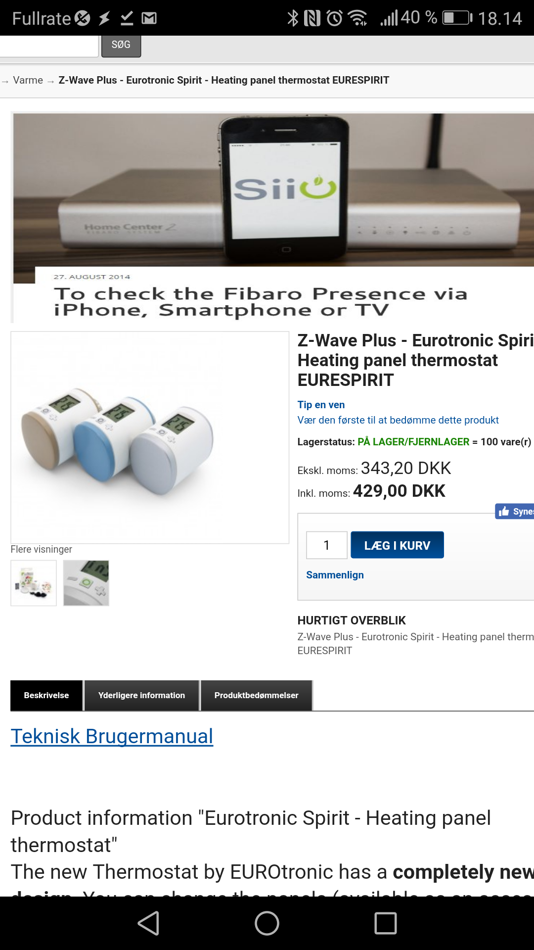

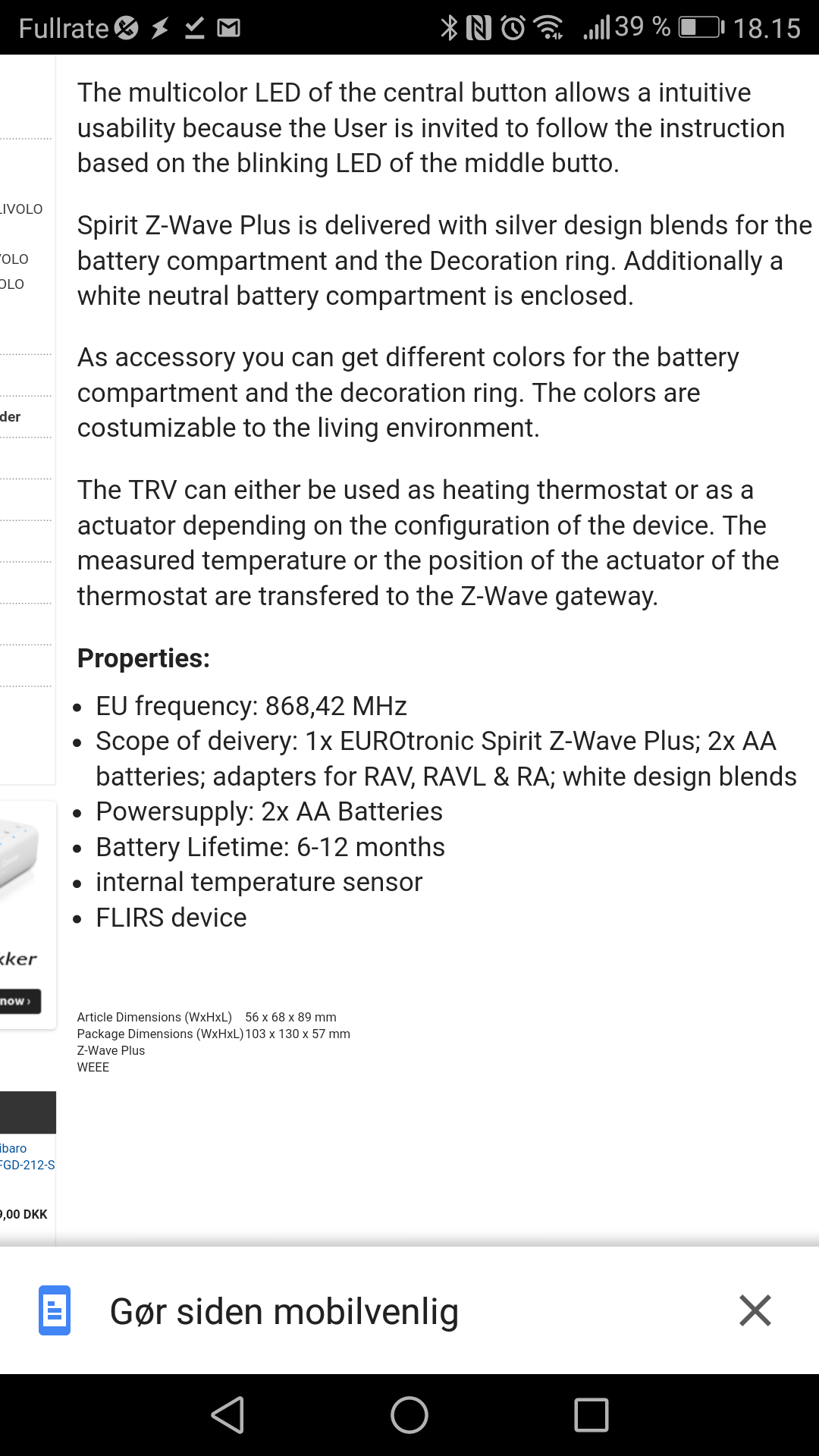

Hi zipato. Is this thermostat compatible with zipabox? I have searched various forums, but did not find an exact answer, so I just whent straight to you. Please see Attachment.
